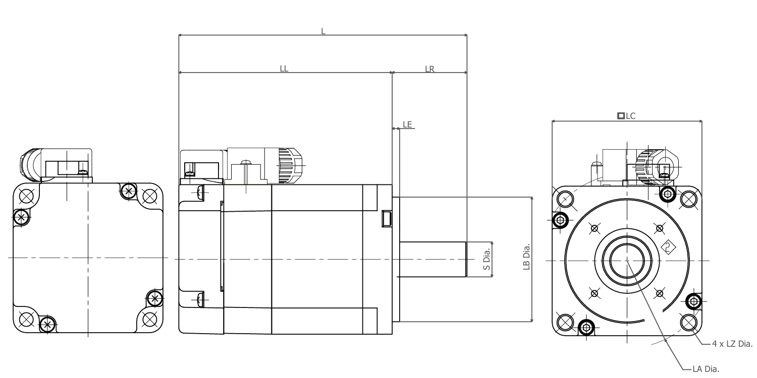

Yaskawa SGM7J/SGM7G Motor Sizes
| Motor Dimension without Brake (Units: mm) | |||||||||||
| Wattage | Motor | L | LL | Flange Dimensions | S | Approx. Mass [kg] |
| LR | LE | LC | LA | LB | LZ | ||||||
| 200 watt | SGM7J-02A7D6S | 99.5 | 69.5 | 30 | 3 | 60 | 70 | 50 | 5.5 | 14 | 0.8 |
| 400 watt | SGM7J-04A7D6S | 115.5 | 85.5 | 30 | 3 | 60 | 70 | 50 | 5.5 | 14 | 1.1 |
| 750 watt | SGM7J-08A7D6S | 137 | 97 | 40 | 3 | 80 | 90 | 70 | 7 | 19 | 2.2 |
| 1 kW | SGM7G-09A7DKS | 195 | 137 | 58 | 6 | 130 | 145 | 110 | 9 | 24 | 5.5 |
| 1.3 kW | SGM7G-13A7DKS | 211 | 153 | 58 | 6 | 130 | 145 | 110 | 9 | 24 | 7.1 |
| 2 kW | SGM7G-20A7D6S | 229 | 171 | 58 | 6 | 130 | 145 | 110 | 9 | 24 | 8.6 |
| 3 kW | SGM7G-30A7D6S | 239 | 160 | 79 | 3 | 180 | 200 | 114 | 14 | 35 | 13.5 |
| 4.4 kW | SGM7G-44A7D6S | 263 | 184 | 79 | 3 | 180 | 200 | 114 | 14 | 35 | 13.5 |
| 5.5 kW | SGM7G-55A7D6S | 334 | 221 | 113 | 3 | 180 | 200 | 114 | 14 | 42 | 21.5 |
