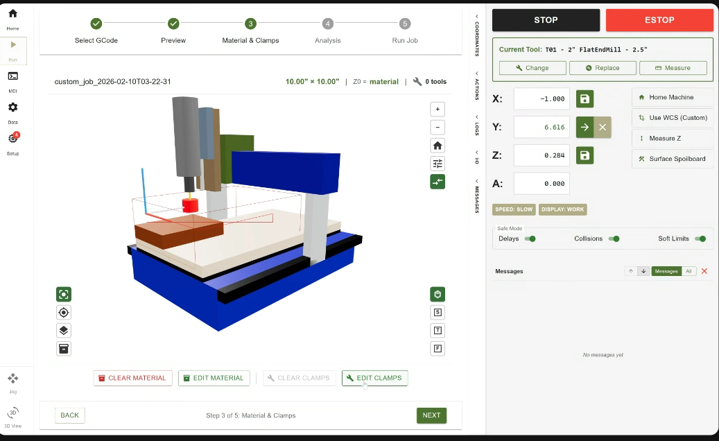

The Centroid API allows users and OEMs to create their own custom CNC solutions by creating applications using Visual Studio and either Visual Basic .NET or C#.
You can create your own Centroid CNC Apps.
Your App will command and control Centroid's CNC12 CNC software.
You can create simple Apps like the Power Feed example shown in the video below or a more complex App that would completely replace the Centroid UI.
Its all up to you!
The Centroid API is free and open, there is no charge to use the Centroid API tools.

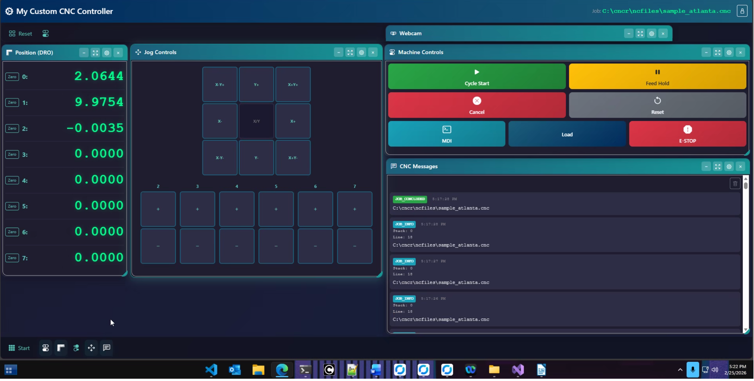

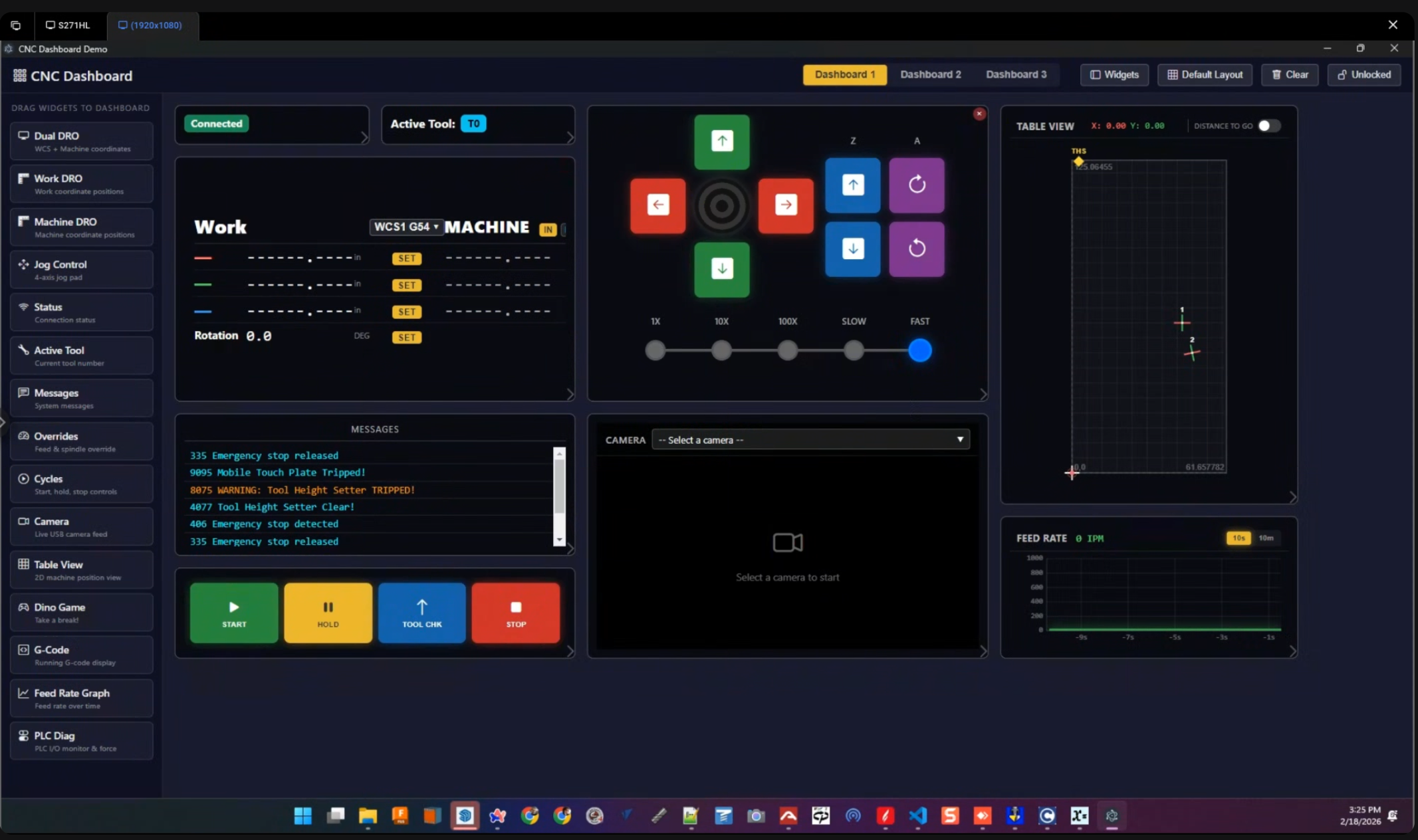

A: Use the Centroid API to create your own custom CNC applications that can run along with CNC12 or completely replace the CNC12 UI.
Your Apps can command motion, control motors, pumps, activate accessories, interface with a robot, read sensors, read inputs, control outputs, run macros, run g codes, display all kinds of machine tool information such as but not limited to: spindle speed, feedrate, WCS and Machine positions. Run probing cycles, set part zeros, interface with 3rd party software. The applications and functions are nearly limitless.
