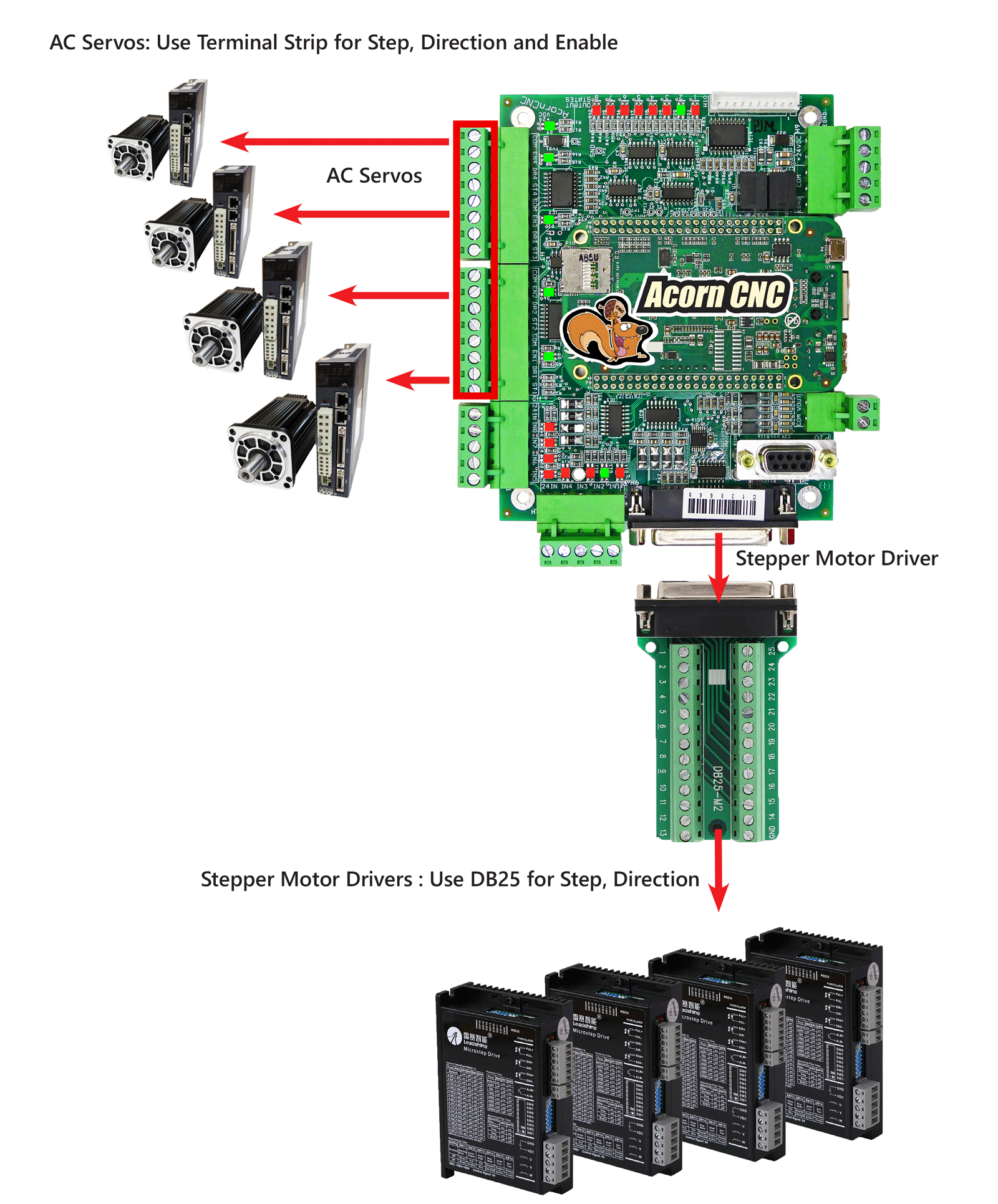

Bench Test Running Motors. Marty shows us how to connect up the Acorn CNC controller to axis motors using the Gecko G540 stepper drive and stepper motors as an example
Bonus: Acorn Input and Output LEDs explained along with Power and Heartbeat and Drive enable LED's
