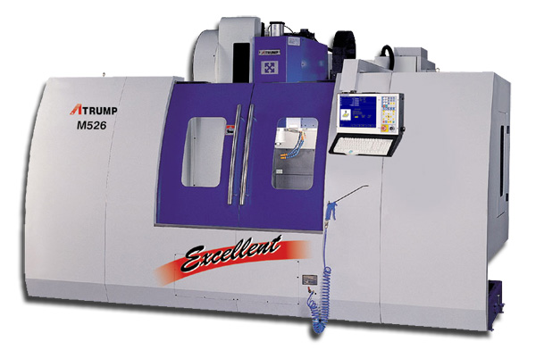

Atrump M526 Heavy Duty Vertical CNC Machining Center:
With 52" of X travel and a 20 pocket ATC this workhorse VMC has large travels and big performance
Atrump CNC machine tools, M526 Heavy Duty Machining center   Designed for shops looking for a Heavy Duty vertical CNC Machining Center with big travels and big performance, the M526 has a work envelope of X 52 " x Y 26 " x Z 27.5 " . Equipped with a CENTROID M400 CNC control this machine uses a 20 pocket Automatic Tool Changer and a 20 Hp 6000 rpm spindle. The M526 utilizes a heavy duty casting with box ways construction on X, Y and Z with a fully webbed cast iron frame for maximum rigidity and vibration damping.This Heavy Duty Machine is designed for the shop with a demanding machining schedule, the Box ways and the full cast iron frame provides the maximum rigidity to meet the variety of machining challenges typically encountered. From Aluminum to Stainless Steel the M526 has the best performance to value ratio in its size range.
