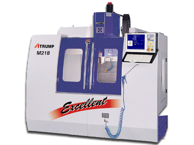

Atrump M218 Super Maxi Mill Vertical CNC Machining Center:
Small footprint, large travels and big performance
Designed for shops looking for a small footprint vertical CNC Machining Center with big travels and big performance, the M218 has a work envelope of X 26" x Y 18 " x Z 24 " . Equipped with a CENTROID M400 CNC control this machine is a heavy duty VMC with square ways on all axes and a super 4 box way design on the Y axis with a super wide saddle. Don't be fooled, unlike other machines on the market in this size range, the M218 utilizes Box ways construction with a fully webbed cast iron frame for maximum rigidity and vibration damping. A Tool Room or Job Shop needs a machine with box ways and a wide saddle with a full cast iron frame to meet the variety of machining challenges typically encountered. From Aluminum to Stainless Steel the M218 has the best performance to value ratio in its size range.
M218 Specifications
Travels X, Y, Z 26", 18 ", 24 "
Work Table 32.5" x 16"
ATC 16 Pocket Armless Auto Tool Changer
Spindle Motor 10 Hp Inverter
Spindle Speed 8000 rpm , programmable
Spindle Nose to Table 4.13" - 27.16 "
Spindle Center to Column 19.68"
Foot Print (floor space) L 89 ", W 96 ", H 100 " (83" w/motor removed)
Weight 7370 lbs
Power 208-240 3 Phase AND 220 single phase
Ballscrews High Precision Class C3 Ballscrews
Table Saddle Super wide Y axis saddle with box way
Way design Large Box Ways on all axes
Air Air hose and nozzle for clean off
Wash Coolant Wash down nozzle
Training and Setup 1 day On site ATC checkout, setup and Training
Servo Motors Digital Servo motors w/ auto tuning
M218 Options
Rigid Tapping Rigid Tapping G code & Special Conversational
High Speed Spindle 12000 RPM
Spindle HP upgrade 15 Hp Inverter motor
ATC Arm Type Automatic Tool Changer
Single Phase Operation Allows 220 vac single phase input voltage
AC Servo motors Fast 1Kw AC servo motor upgrade.
Service Contract 1 Year Service Contract, includes 1 day training.
