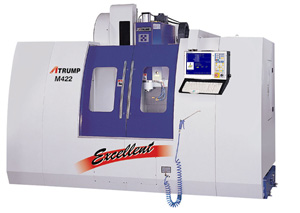

Atrump M422 Heavy Duty Vertical CNC Machining Center:
With 42" of X travel and a 20 pocket ATC this workhorse VMC has large travels and big performance
CNC Machining Center Atrump Heavy Duty M422   Designed for shops looking for a Heavy Duty vertical CNC Machining Center with big travels and heavy capacity, the M422 has a work envelope of X 42 " x Y 22 " x Z 27.5 " . Equipped with a CENTROID M400 CNC control this machine uses a 20 pocket Automatic Tool Changer and a 15 Hp 8000 rpm spindle. The M422 utilizes a heavy duty casting with box ways construction on X, Y and Z with a fully webbed cast iron frame for maximum rigidity and vibration damping.This Heavy Duty Machine is designed for the shop with a demanding machining schedule, the Box ways and the full cast iron frame provides the maximum rigidity to meet the variety of machining challenges typically encountered. From Aluminum to Stainless Steel the M422 has the best performance to value ratio in its size range.
