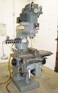

Classic Bridgeport Boss 5 NC knee mill ready for a retrofit!
Bridgeport manufactured a large number of "Boss" machines throughout the 70's and 80's. These machines are of high quality and make an excellent choice for a CENTROID CNC retrofit.
There are many other brands of good high quality machines available on the market today for reasonable prices. The original controls have gone past their useful life and the machines themselves have outlived the electronics. Often older NC and CNC machines can be found in excellent mechanical condition. These machines usually have been a nightmare to operate and maintain since the stock control is so outdated. Also, many of these old controls were never really that good to begin with and since the original systems were so difficult and problematic to use it is common to see early NC machines with low hours on them...prime for a CENTROID retrofit.
Remove the old NC control
The first step is removing the old NC control from the machine. With a Boss machine this only takes about 30 to 45 minutes. The old Boss 5 control has two cabinets, one on the right and one in the back of the machine. Both are removed reducing the footprint of the machine significantly.

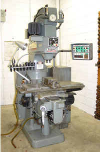

Mount the operators console
Mounting the console is quick and simple, all the brackets and hardware are supplied with a CENTROID retrofit kit. We simply drilled and tapped 4 holes and bolted the supplied bracket onto the side of the ram. Then we install the center pin for the hinge at both ends and hung the operators console. Once the console was hung, we simply connected the flexi-conduit to that runs from the console to the control magnetics cabinet.
Power up and checkout.
  Now there are only a few things to finish connecting such as the power cables for the accessories and then we are ready to power up and proceed with the control configuration and check out. Since we have used a complete CENTROID CNC kit with new motors and all new control electronics this machine is not limited in any way by the technology originally used. It is now a much more capable machine and much more reliable and user friendly. It is now compatible with modern computer equipment and programs and is software updateable, unlike the old control which sealed its doom.
