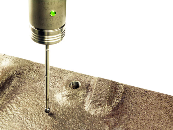

CNC blueprinting with automatic engine block probing, measures bore diameters automatically   Automatic CNC Block Blueprinting: CNC Probing.
Blueprinting any block begins by making very accurate measurements of the existing features so corrections can be made. The old way of laborious manual measurement has been eliminated. The CENTROID B4250 CNC Block machine is equipped with a high tech digitizing probe which automatically locates and measure cylinder bores (diameters, locations and angles), deck heights, and lifter bores with our exclusive easy to use block specific conversational software. To measure an entire block, simply choose the features to blueprint and the probe automatically measures the block and displays the actual diameters and positions of the cylinder bores (and other features) and compares it to the factory specs. The operator then chooses to make any modifications necessary.
The CENTROID DP-4 Probe is a state of the art, made-in-USA highly precise probe which can detect in all axis and directions. Since the probe is made by CENTROID the entire probing system is integrated and streamlined into the CNC machine, making block digitizing and probing a quick and simple process. Much more accurate, faster and repeatable than manually blueprinting a block!

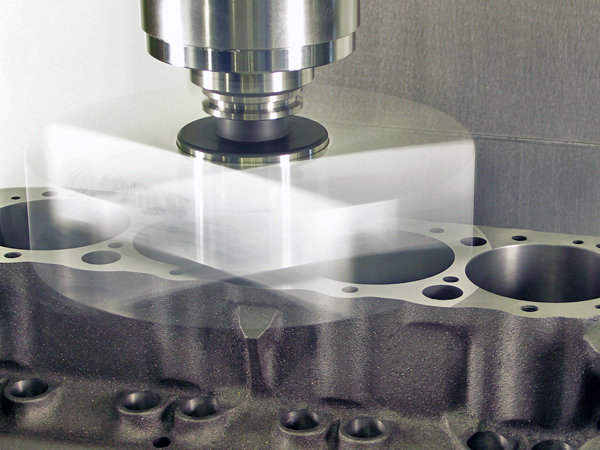

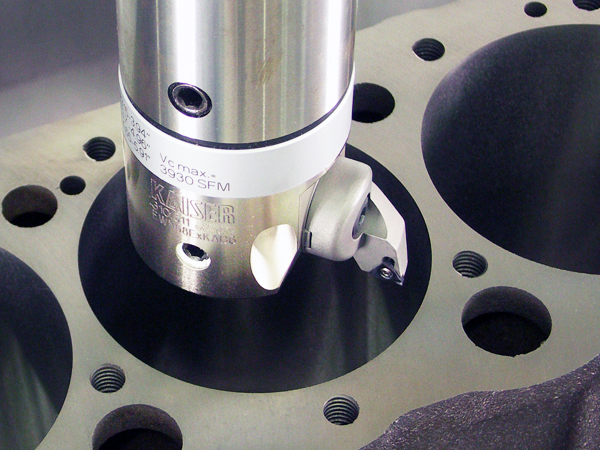

CNC Flycuting an Engine Block   CNC Engine Block surfacing.
With a quick push button tool change the machine will surface the block to the exact deck height specified. The probe automatically detects the block existing surface height at multiple locations so the operator can choose the proper surface depth to machine to for a perfectly flat and square deck to the cylinder bore. Specialized CNC block surfacing tooling is included which produces incredibly smooth surfaces for superior gasket performance.

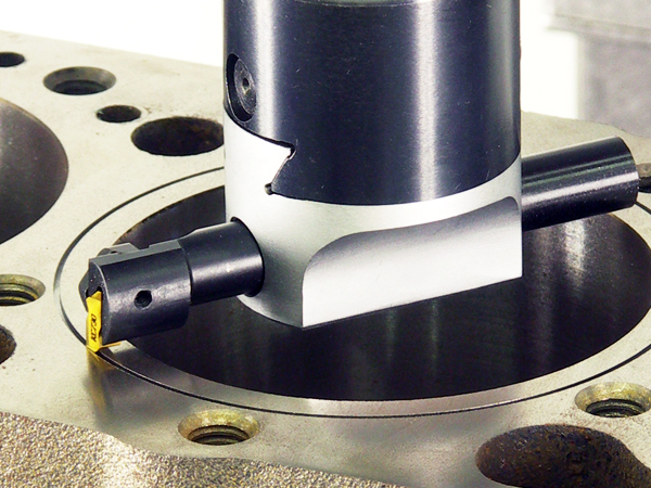

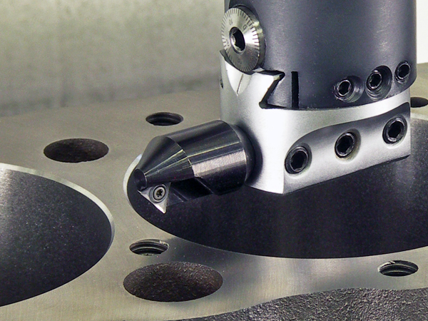

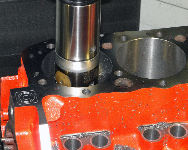

CNC Block Boring CNC Engine Block Boring.
Automatic Boring cycles are pre programmed and are menu driven with a simple fill-in-the-blank format. 360 degree CNC rotary axis will position the block at the exact blueprint angle automatically. Machine both cylinder banks with the same setup. Block data base saves your work for future jobs. Bore on probed centers, Blueprint or any other specified location. Specialized boring tooling included. Quick, simple programming gets the job done accurately the first time. Operators program the block work to be done right at the machine.

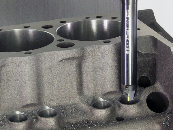

CNC Lifter Boring   CNC Lifter Bore Machining.
Machine lifter bores to the exact diameter, location and angle needed with one simple setup. True up the stock size and location or bore complete new diameter, location or angle. Easily control feed and speed within the CENTROID conversational software, the computer remembers your data for the next job as well, no need to reprogram. Easy manual override of programmed feeds and speeds via the operator control panel makes fine tuning adjustments easy to do on the fly.

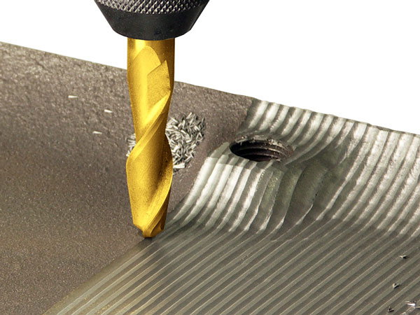

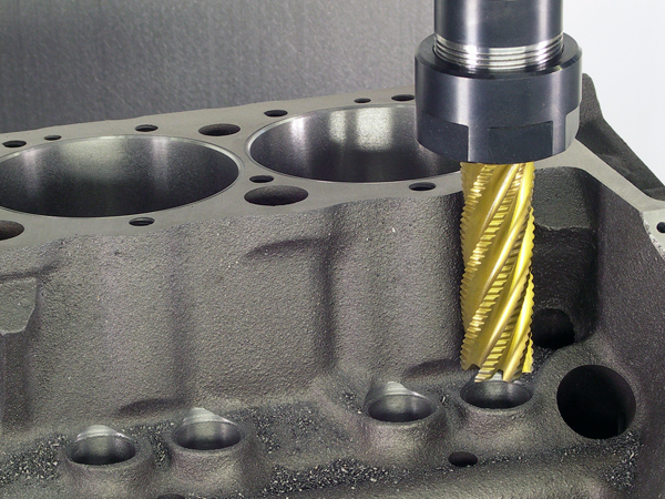

CNC Lifter Bore Spot Facing   CNC Spot Facing
Spot Face Lifter bores automatically. You have the ability to create and save your programs with CENTROID user friendly CNC Block software. No need to go out of house or learn G codes, our easy to learn Block Software is made specifically for engine builders saving you time.

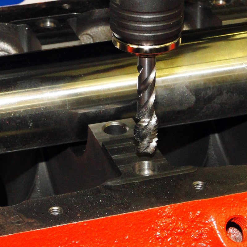

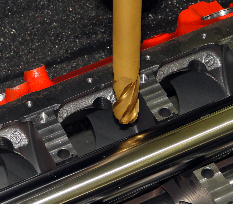

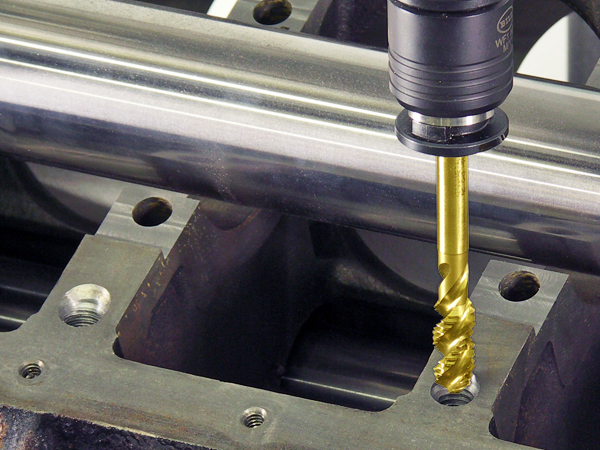

4 Bolt Main Bearing Cap Conversion   4 bolt Main Bearing Cap Conversion.
The best way to accurately convert a block to 4 bolt mains. Automatic CNC drill and tap routines are pre programmed, the operator simply answers a few questions and the machine does the rest. CNC Angle Drilling and tapping for perfect 4 bolt main conversions.

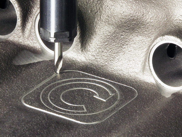

CNC Block engraving CNC Engine Block Engraving
Quickly and easily engrave letters, numbers, symbols and logos. Phone numbers, serial numbers, web addresses and company logos are now simple to automatically add onto every block you blueprint.

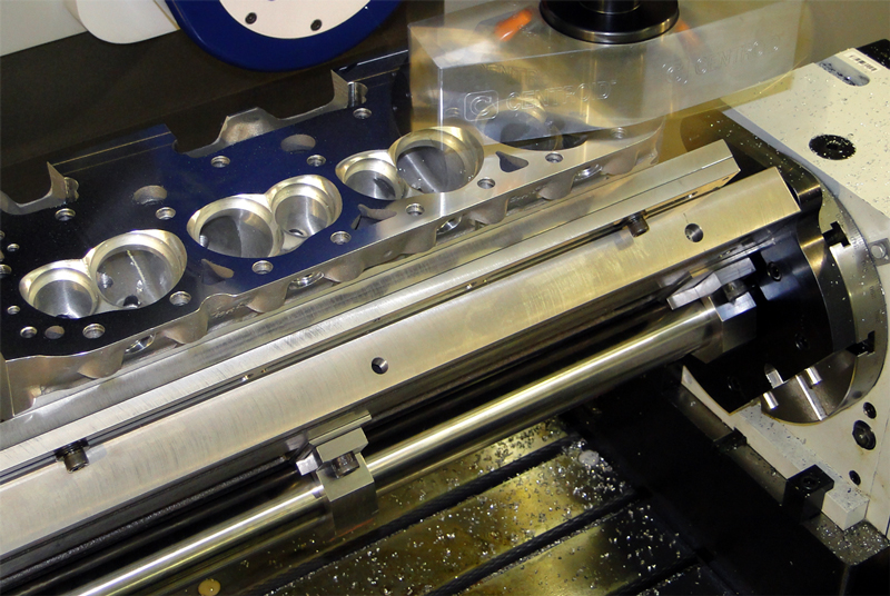

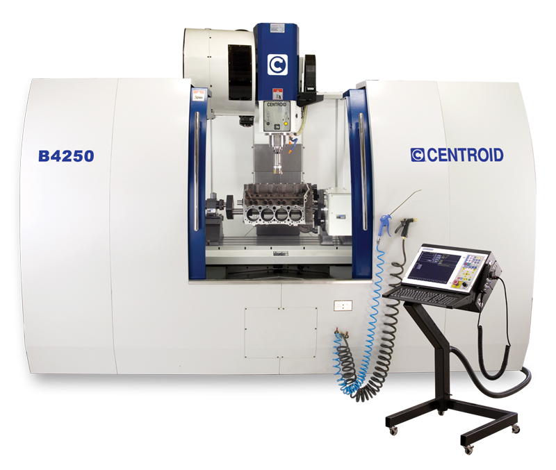

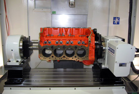

Large Heavy Duty Cast Iron frame has over 5 feet (64 inch) table support!
Super rigid no-sag design is accurate over the entire length of the block.
CNC Engine Block machine Heavy Duty design has a wide table saddle providing full support over the lenght of the block.
B4250 Machine Highlights
  • True 4 axis CNC
  • Rigid Box guideways
  • 360 degree CNC rotary table
  • 2420 lb table max load!
  • Weighs over 8000 lbs.
  • Fully webbed casting.
  • Precision C3 double nut ground ballscrews.
  • Laser tested for accuracy.
  • CAT 40 Tooling.
  • Quick push button tool changes.
  • Rigid Tapping equipped.

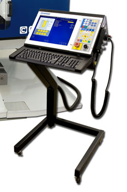

Engine Block 4 axis CNC control.   CENTROID Conversational CNC control.
Our CNC Block conversational software is a integrated part of the control system. This quick and simple to use Block specific software guides you thru the process with graphics and a simple fill in the blank format. Our Block blueprint data base is standard and expandable, nothing extra to buy. Operators can easily add their own work to the data base. The control remembers all your data and programs. Easy transfer to a USB thumb drive for backup & safe keeping, USB 2.0 ports are a standard feature of the PC based CENTROID cnc control along with a robust solid state hard drive made for harsh environments for reliable operation for years to come.
A large color LCD screen with an anti glare layer makes the control easy on the eyes, grease and chip proof. The operator control panel has dedicated buttons for common machine functions that makes the control simple and intuitive to use. The included electronic remote hand wheel makes block setups quick, accurate and easy. Simply turn the dial to move a machine axis, a selection of increments on the dial allows fine adjustments. The control stand itself allows and operator to stand or sit with a comfortable working position.
The CENTROID M400 CNC control is a full function 4-Axis CNC that has additional built in conversational pre programmed canned cycles for everyday machining tasks, such as automatic pocketing (circular, rectangular, irregular with cleanout), drilling cycles( peck drilling, deep hole and regular), Tapping (compression, reversing and Rigid! w/ special deep tap cycles), Frame milling, Engraving, Lines, Arcs, repeat, rotate, mirror, depth repeat and much more...
In addition to the extensive conversational software the CENTROID M400 is a G&M code CNC control which uses industry standard G codes so you can use any CAD/CAM system to program a part.
