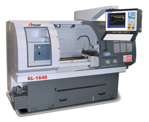

Atrump KL1640NC CNC Flat Bed Tool Room Lathe:
Med sized workhorse Tool Room CNC Lathe with quick setup and easy programming
CNC Lathes, Atrump Tool Room CNC Flat Bed Lathes.   Designed for Tool Rooms and Job shops looking for an affordable medium sized Flat Bed CNC Lathe, the KL1640 has a spindle through hole of 2.125" with a 7.5 HP spindle motor coupled to a 3 speed gear box there is plenty of torque for heavy turning or hard to machine materials. This versitle flat bed lathe features easy programming and fast setup with the CENTROID T400 CNC control. The KL series lathe utilizes a massive one piece meehanite casting that has been annealed and stress relieved for maximum rigidity and vibration damping. Designed for repair, prototyping and low run production, this tough Lathe is ready for all the machining challenges typically encountered by Tool Rooms and Job shops. Its just as easy to make one or hundreds of parts. . From Aluminum to Stainless Steel the KL series has the best performance to value ratio in its size range.
