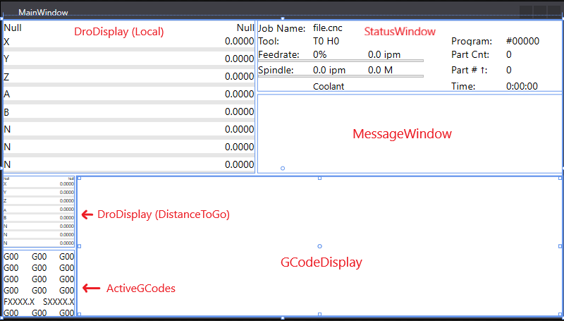

Adding User Controls To Your Design
Click and drag these User Controls from your Toolbox into your design:
  • DroDisplay (Local)
    • Name the DroDisplay Dro in the Properties Window.
    • In the Miscellaneous Property category, choose DRO_LOCAL for the DroType.
  • StatusWindow
    • Give it the name StatusWindow in the Properties Window.
  • MessageWindow
    • Give it the name MessageWindow in the Properties Window.
  • DroDisplay (DistanceToGo)
    • Give it the name DroDistanceToGo in the Properties Window.
    • In the Miscellaneous Property category, choose DRO_DISTANCE_TO_GO for the DroType.
  • ActiveGCodes
    • Give it the name ActiveGCodes in the Properties Window.
  • GCodeDisplay
    • Give it the name GCodeDisplay in the Properties Window.

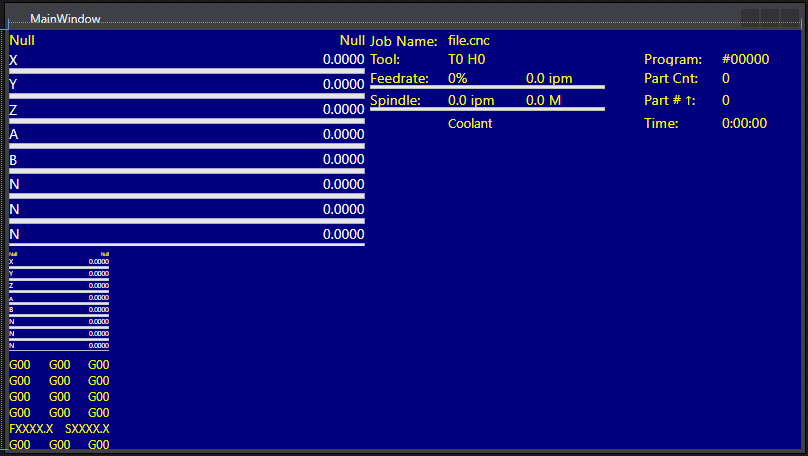

Window Color Formatting
To match the CNC12 color scheme, set the following properties:
  • MainWindow -
    • Change the Background property color to RGB(0, 0, 128).
    • Change the Foreground property color to RGB(255, 247, 0).
  • Dro Controls -
    • Set the DroTitleColor to RGB(255, 247, 0).
    • Set the Forground color to RBG(255, 255, 255).
    • Set the LoadBarBackgoundColor property to No brush.
    • Set the LoadBarBorderColor property to RGB(255, 255, 255).
  • ActiveGCodes -
    • Set InactiveGCodes property to RGB(127, 127, 127).
  • GCodeDisplay -
    • Change ActiveLineBorderColor to RGB(255, 255, 255).
Your window should now look like this:
