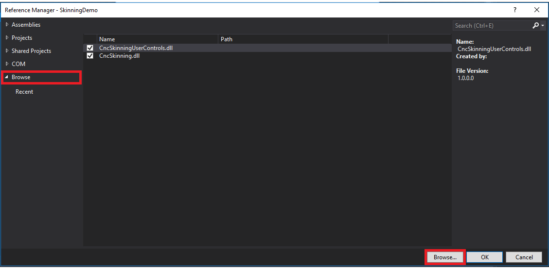

Referencing the CncSkinningUserControls.dll file:
In the Solution Explorer, under your WPF project, right click on References and select Add Reference....
Choose Browse category, then click Browse... and navigate to the location of CentroidAPIUserControls.dll. Select it, then press OK.

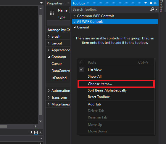

Adding User Controls To Toolbox:
Right click on Toolbox Window, and select _Choose items...
Click Browse and navigate to where CentroidAPIUserControls.dll is stored. Click on it, and press Open
Press OK to add to Toolbox. You should now see the user controls in your Toolbox.
