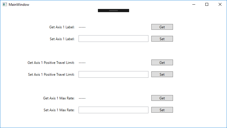

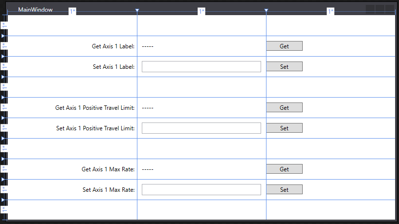

Designing Your MainWindow.xaml
Add Labels, TextBlocks, TextBoxes, and Buttons to your MainWindow.xaml to display the data to be received from, and sent to, CNC12. Your MainWindow should look something like this:
Here is the MainWindow.xaml code for the above picture:

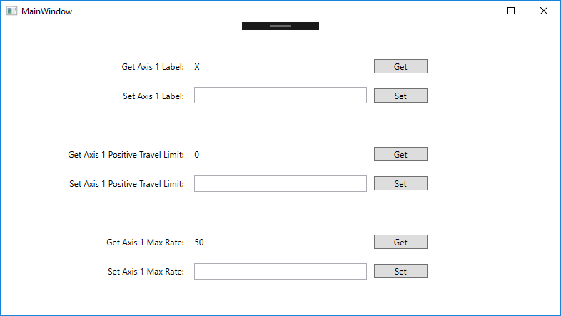

If CNC12 is running and the api connection has been established successfully, your program window will look like the below image. If you get the pop up that was set up previously, check to see if CNC12 is running, finished initializing, and error free.
Pressing all of the "Get" buttons should retrieve the relevant data from CNC12. In this example's case, the values below appear.

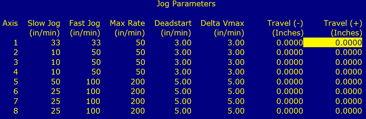

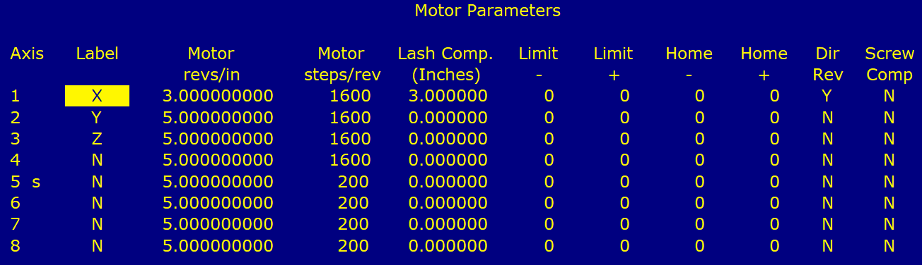

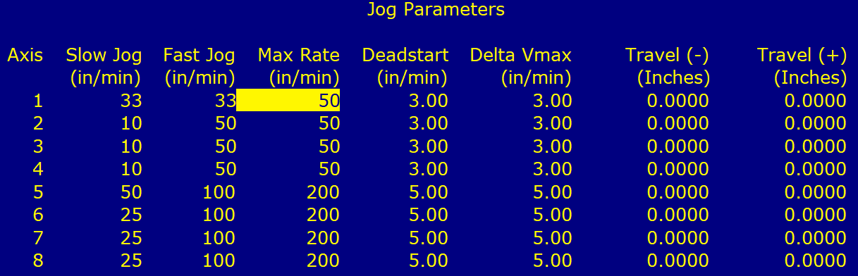

These values can be checked against the values in CNC12. The relevant menus can be accessed from the Main Menu by:
  • Motor Parameters: F1 -> F3 -> F2 -> F2
  • Jog Parameters: F1 -> F3 -> F2 -> F1

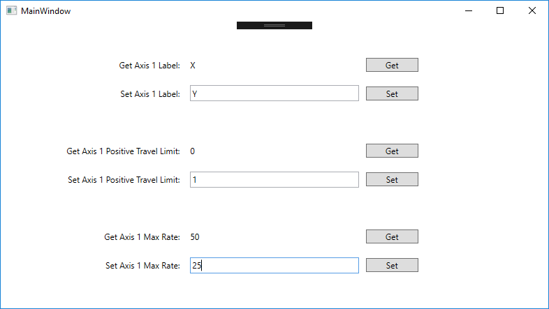

Next, type in the values below into the TextBoxes and click each "Set" button.
Click all of the "Get" buttons again, and the values that you set previously will appear.
