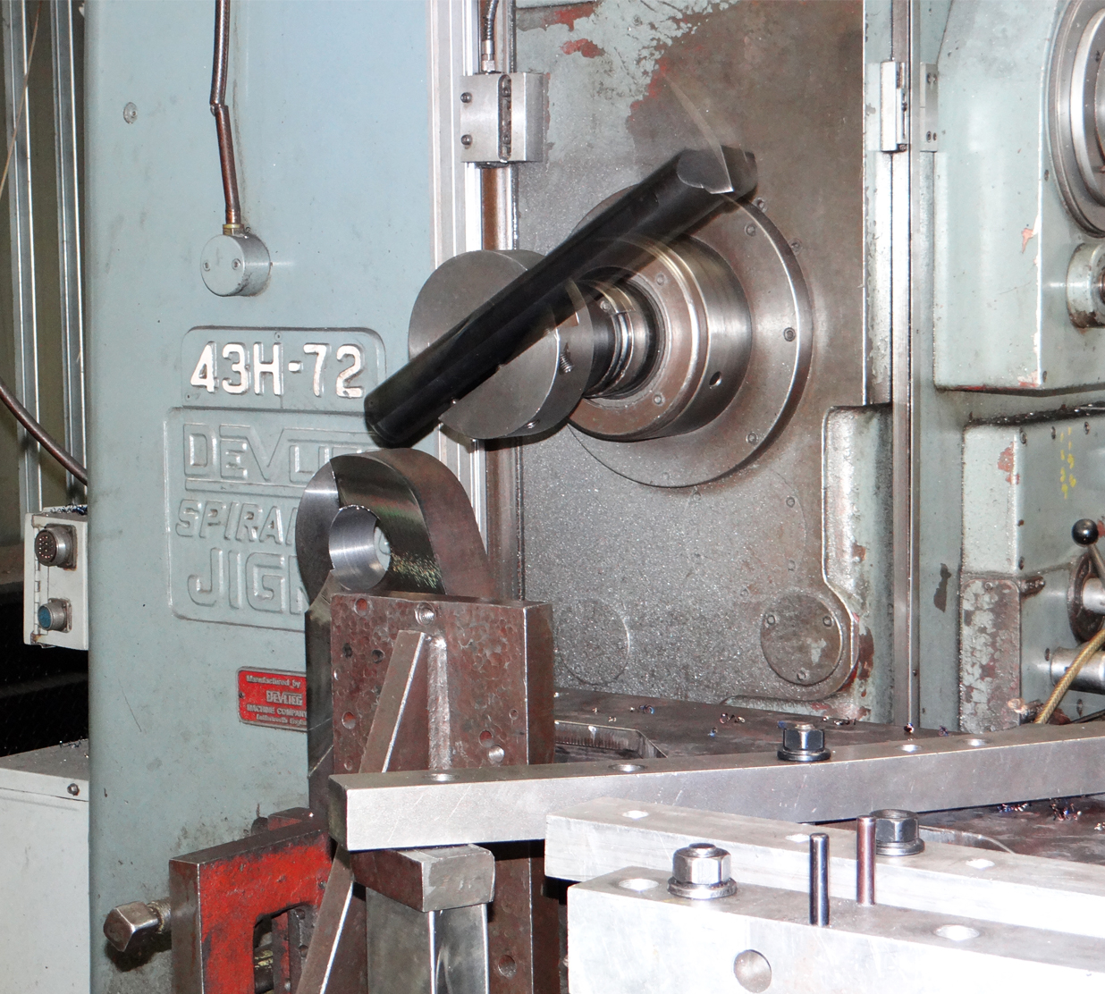

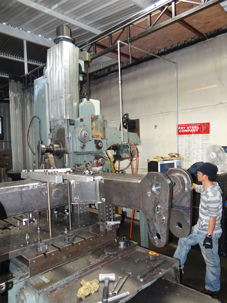

DeVlieg 43H-72 Spiramatic Jig Mill CNC retrofit upgrade.

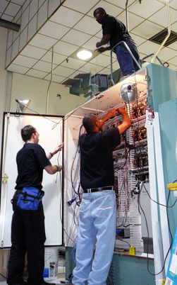

With worn out Mitsubishi CNC control electronics that were cumbersome and expensive to maintain it was time to bring this classic machine back to life. A new CENTROID M400 CNC control has made this machine profitable again. Utilizing the advantages of the CENTROID MPU11 motion controller along with the GPIO4D controlling Yaskawa servo motors and drives, the new control system is reliable and easy to program.
This DeVlieg 43H-72 is one of two located at this shop in southern California and was retrofitted by William Atkinson, CNC Matters.com.

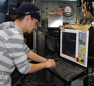

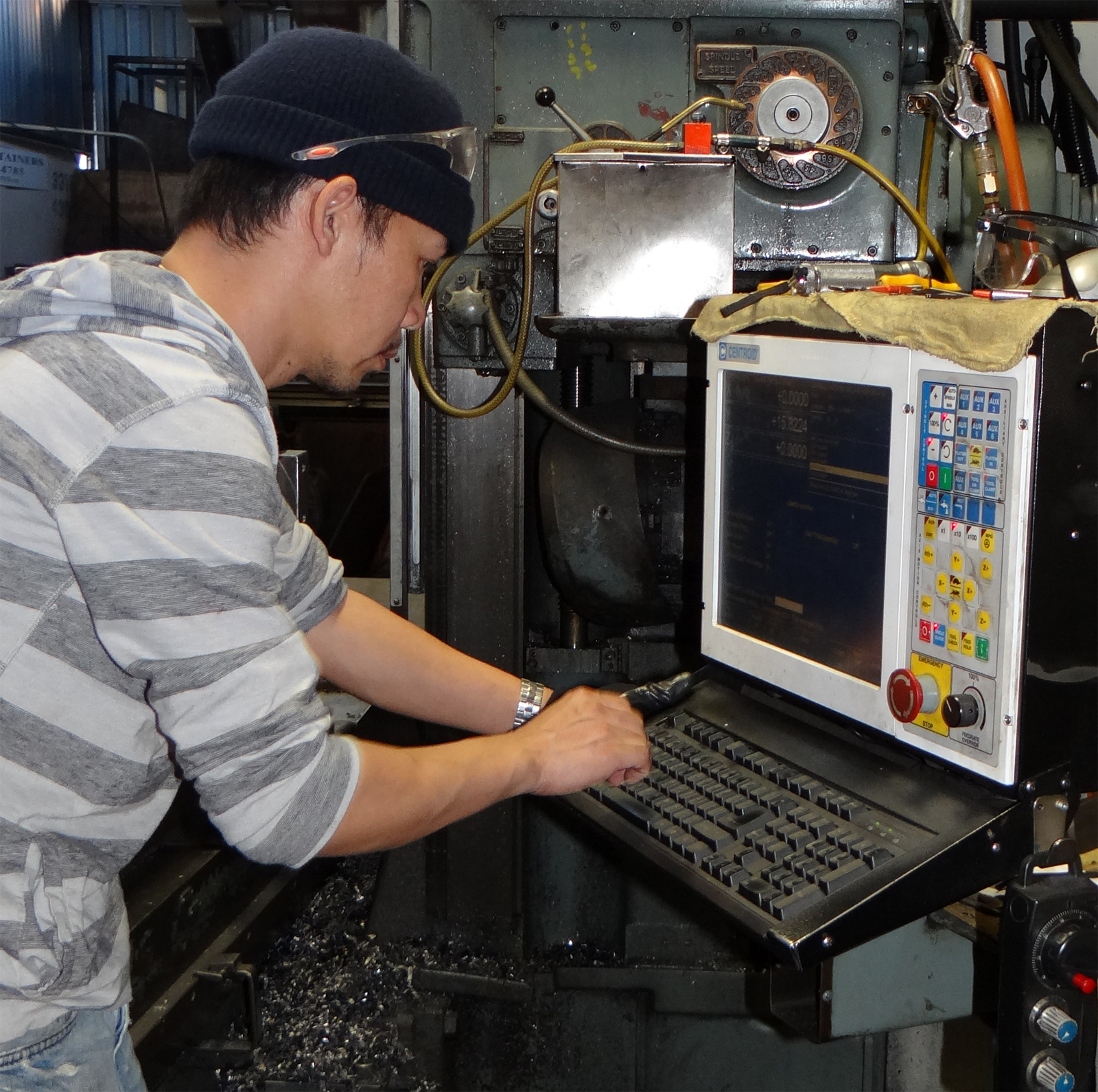

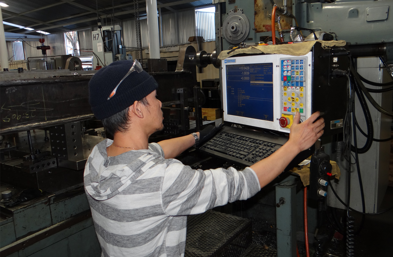

DeVlieg operator runs G code programs and uses graphical part setup menus and Smart Search.
Smart search allows the operator to stop the job at any point, check his work and then pick up right back where he left off or at any other location within the G code program. Due to the size of the parts this customer works on, it is common to have to setup and relocate the part on the machine many times to complete the job. Centroid fast and easy part setup menus help the operator make accurate setup quickly for a no mistake setup.
